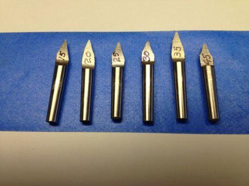

Topic: Engraving Bit
Replies: 7
Re: Engraving Bit
These graduations were done with a cutter I ground, should have twisted the spindle to show the cutter profile.
https://lh3.googleusercontent.com/-pvOH ... G_0325.jpg
Greg
by f350ca
Mon May 16, 2016 5:00 pm
Forum: General Discussion
Replies: 7
Re: Engraving Bit
I've had good success making cutters like this from broken carbide drill bits.
Grind to a point as you did then grind away half the thickness.
Greg
