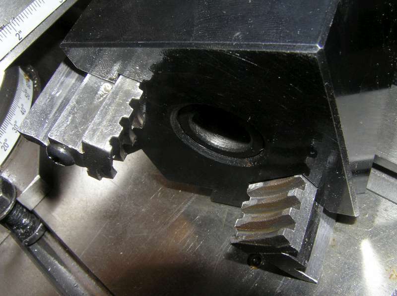

Of course, being a curious fellow, I wanted to see how it worked. With the base removed, the wedges can retract all the way off:
From the side, you can see the worm screw. Turns out this is a multi-start thread and unscrewing it far enough to remove the wedges qualifies as a Bad Idea(tm). Kind of like removing the jaws from a chuck without knowing which one goes in which slot. Now we have to experiment to find the right combination so that a) the wedges rise and fall in unison and b) the lever ends up in a good place -- as in, not directly over the wedges when trying to change tools! So do yourself a favour and leave them where they are. Satisfy your curiosity from the picture:

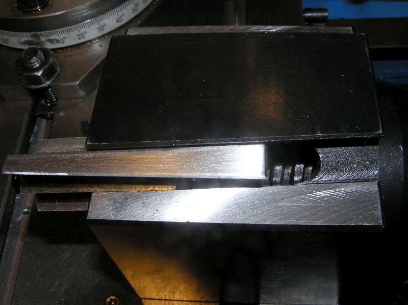

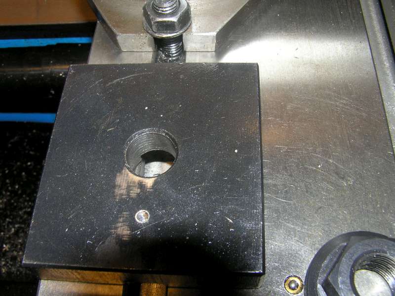

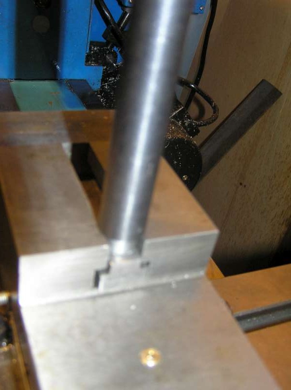

Ok, back to the installation then. Step one was to unscrew the centre MT rod and drill out the threaded hole to 5/8" -- same diameter as the rod. Also, I drilled and tapped a bolt hole to accommodate a key:
A slot, sized the same as the compound slot, was milled in the underside to accept the key:

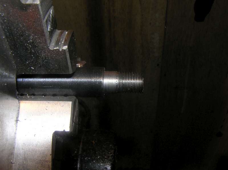

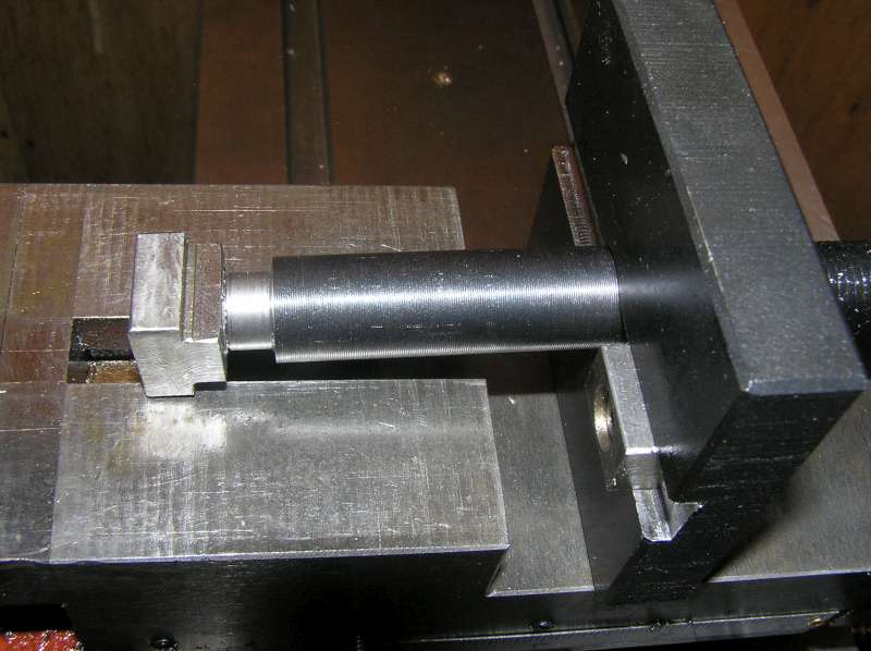

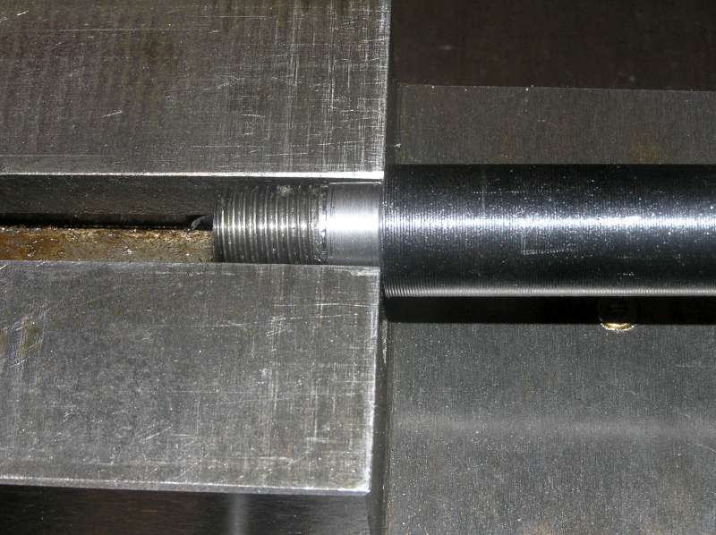

Next, I turned down the end of the MT rod to a couple of thou under the same width. A few more thou off the end allowed me to thread it for 7/16 NF:

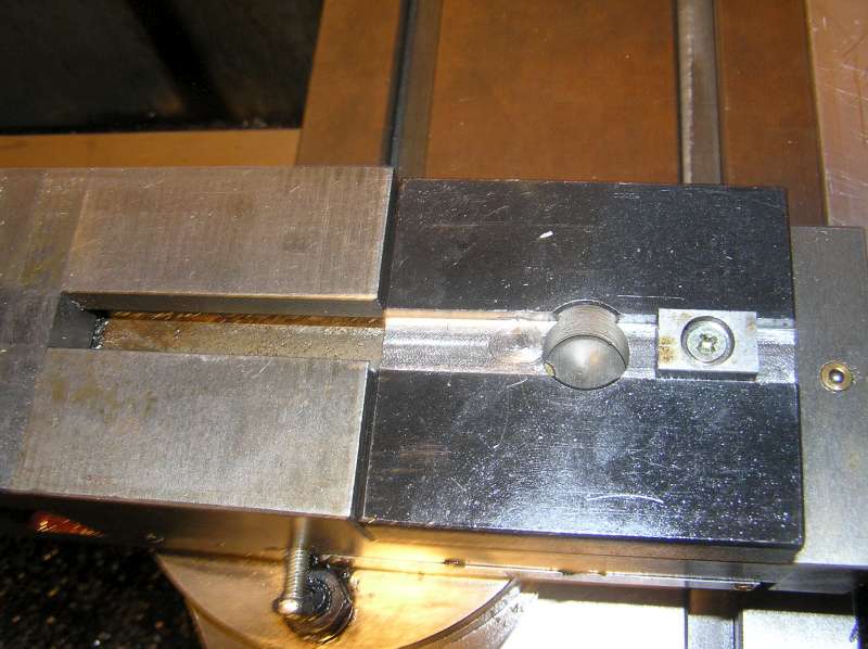

This will allow the rod to pass through the compound t-slot:
A custom t-nut was milled from CRS to complete the package:

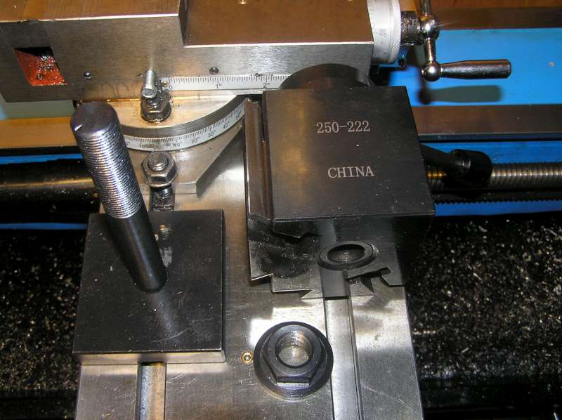

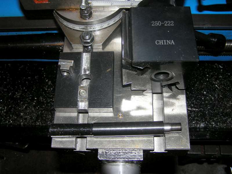

Here's all the parts, as modified:

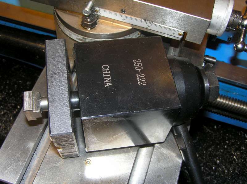

And assembled:

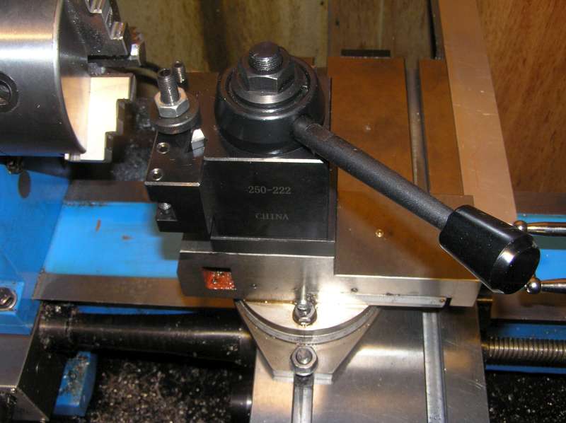

Ok, with the wedges correctly assembled to the worm screw, here's where the handle ends up when locked:
and unlocked:

1. Allen key setscrews on the toolholders. I can see where those are going to fill with chips eventually. I like the square headed setscrews on the original turret post. I think I'll make some to fit these toolholders.
2. it needs something with a lever to replace that nut on top. It's a PITA to keep reaching for a 1" wrench to change the tool angle.
3. I need to figure out some way of indexing the angle of rotation. It would be nice to have a positive stop when square and at least at 29° (for threading).
On the plus side, the wedge action is exactly as advertised: with the locknut loose, the adjuster is easily turned to quickly fine tune the height. But when the lever is locked, the adjuster is snugged right down against the toolpost and cannot be turned by hand. The locknut is really just necessary to prevent inadvertent changes when the holder is kicking around the tool box.

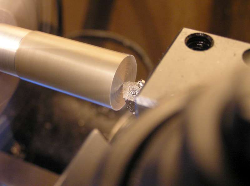

One of the advantages of a wedge QCTP over a piston is repeatability -- that is, the tool tip will end up in exactly the same place when swapping it in and out. Generally I have found this to be true, at least for regular lathe bits that don't stick out very far.
However, yesterday I discovered there is a limit, at least, on this model when used with a long boring bar. I found it can vary up to 0.0015" (total, ie: +/- 0.00075") at the tip when removed and replaced. This was on the far side wedge, so maybe I had a fine chip in there that I missed wiping off or something. I was making several pieces requiring a press-fit for a bearing and found I had to slightly adjust the DRO each time I removed and replaced the boring bar. If I was just boring some bolt holes it might not matter, but that much variance is the difference between a nice press fit and the bearing falling out!

Torch wrote:One of the advantages of a wedge QCTP over a piston is repeatability -- that is, the tool tip will end up in exactly the same place when swapping it in and out. Generally I have found this to be true, at least for regular lathe bits that don't stick out very far.
Yup...first one I had was a piston. Got it when I didn't know better. Wasn't much for repeatability either. Other problem was, it didn't like intermittent cuts, and would come loose if I didn't keep slappin' the handle to keep it tight. I broke it off at the threads a couple times.
I have an air hose on my lathe, and clean the post & the tool-holders off between changes. If I'm using oil, and things are messy, I'll wipe things down too. I made a paperweight instead of a bushing one time, for the very reason you're talking about. I had a 1" boring bar hanging out of the holder about 5". Doesn't take much of a chip to foul that up.
