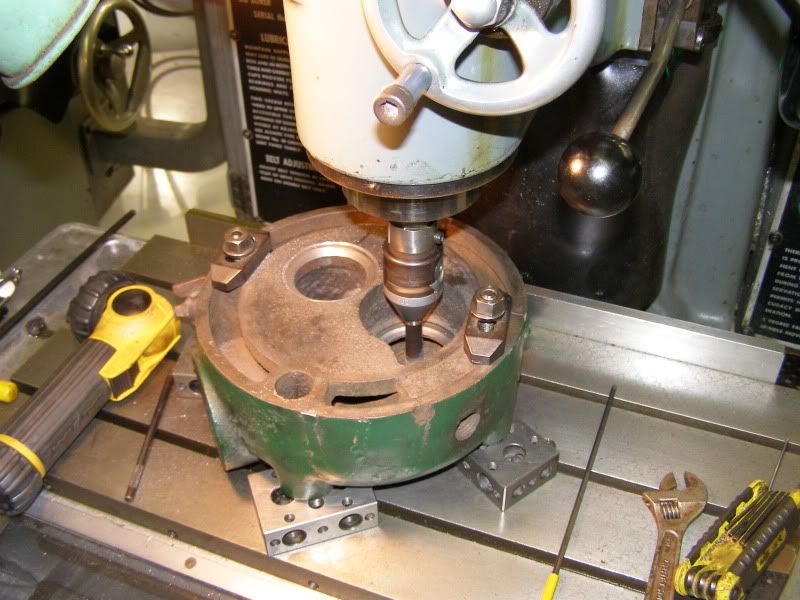

Next up is the cylinder head. Really badly worn valve guide bores, and to top that off a previous owner poked a reamer through them to oversize them. The intake valve bore wasn’t too bad, but the exhaust bore was a mess, as not only didn’t the bore clean up, but the reamer went in crooked as well, as it was apparently done with a hand drill. The valves are also a mess as they cut off the old stems and welded on larger dia stems, then turned them down a bit to fit the bores. The stems were no longer concentric with the heads as they must have chucked them up using a three jaw with about .007” runout!
Anyway, the exhaust guide bore was repaired by putting it back on location and sleeving it with bronze so that new stock valves can be used. I considered making the valves, but used a bit of sense and ordered them new, as they are available for $38.00 each.
Here the guide has been repaired, and the seat rough machined. It will get touched with the seat grinder after the new valve is properly fitted.
Now the intake guide bore will get the same treatment.
Running the boring bar through the guide bore to get it straight and round again and ready for a bronze sleeve.
Hopefully, this thing may actually run pretty well whan it's done! It's throttle governed rather than hit and miss, and runs on Kerosene. It has a small gas reservoir that is used to start it and warm it up prior to switchig to kerosene.

I'm curious about your choice of honing head. Is there a reason you didn't use your large Sunnen to hone the .375" bore? Looks like you were working out of the pan. Must be something I don't know that lead to your decision.

I had the honing machine set up for a different job and didn't want to go through the whole drill ofor one small bore. My machine possibly differs from yours in that the spindlenose is adjustable so you indicate the mandrels in so they run perfectly true so the part does not wobble, therefore achieving greater accuracy. It is actually a very nice feature, but can take a few minutes to center up.
I also have the stand and drip tray off of my old lathe that I use as a honing stand along with a pump system for the oil. I use it for honing the guides on the V-12 cylinder heads. I use the gimbal mount hand held hone in the above pic with a pneumatic drill to do so, and it is a very nice, very accurate, honing setup once you develop a feel for it. I had a leaky hose on that system, so I just used the hand held hone in the tray of the larger machine, as I already had an air hose over there as well.
