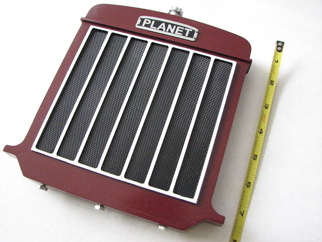

A few years back I purchased a Maxitrak "Planet" locomotive. Essentially in stock form it is a simplistic model of a 2' gauge British 0-4-0 industrial gas mechanical locomotive. As far as a I know I am the only person here in the US who has one of these, making it the only 4.75" gauge Planet built to date. It was always my intention to customize it to be a little more North American in appearance. I did make one color change on the locomotive by painting the red/orange buffer plates black which was a step in the right direction, but I knew I could do better, and a few months back I started planning for a full rebuild of this engine into something truly American.
The stock locomotive is maroon with cream lining. It has some simple details. It is powered by a single 12v deep cycle battery. It has two motors, gear drive and spring suspension.

So, lets get started. The Maxtrak uses a combination of metal and plastic detail parts. I am not wild about the use of plastic in some cases, so for the most part, anything I am adding will be fabricated from metal. The radiator on the locomotive is however a large and heavy piece of solid plastic so for this particular component I am going to stick with that medium. The stock radiator has an etched brass name plate that says "Planet". In it's place I will be adding raised lettering that says "Plymouth". One of the real distinguishing characteristics of classic Plymouth locomotives are the Modine radiators which were built up from vertical cells bolted to upper and lower cast heads. The upper head had the Plymouth name cast in in raised lettering. To replicate the look of the Modine radiator I am using laser cut letters. I am also laser cutting the parts to detail out the upper and lower caps of the radiator cells.
The stock Planet radiator.

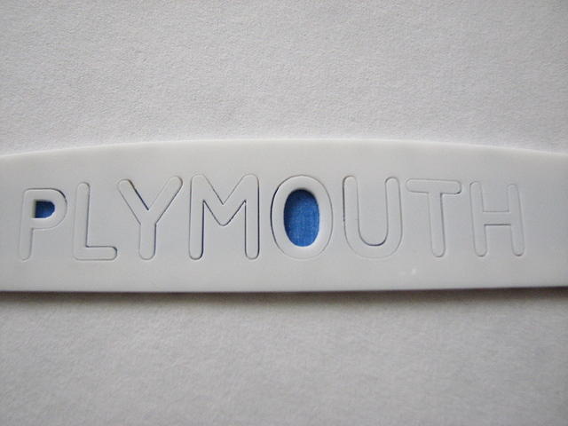

The laser cut Plymouth lettering still in place in the locating template and the Modine style caps. The material is white acrylic.
Detail shot of the Plymouth lettering. JB weld was carefully applied to back of each letter with a toothpick. The letters were then glued in place on the radiator head using the locating template to align them.
Here are the letters glued in place. I created a "fillet" around each letter with gap filling CA glue to provide the look of a casting.
The little holes on the Modine style caps will be drilled and tapped and the 2-56 brass hex head screws will be installed.

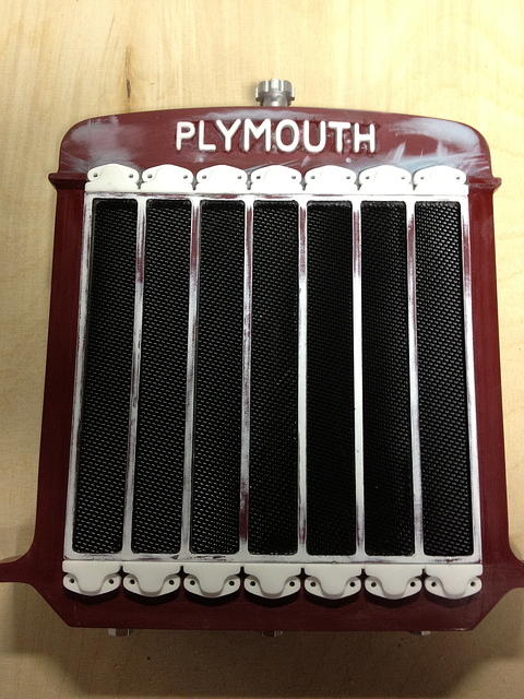

Happy holidays industrial railroaders! Moving ahead with progress on the Plymouth I have a major update today! One detail I had to incorporate was the hand crank starter. Early Plymouths, like early automobiles, had a small shaft coming from under the radiator to which a hand crank could attach. This, of course, was for starting the engine. Since the little industrial locos often had such long service lives they were often retrofitted in later years with electric starters. The crank start shaft was usually left in place. Why bother removing it right? This was the Case on West Side Lumber Plymouth No. 1.
Here is the crank starter that I fabricated. I milled a little "mouse hole" in the lower radiator head casting for the crank shaft to poke out from.
Here is the prototype crank shaft as seen on Mission Cement No. 4 at Ardenwood Park CA.
Astute viewers will notice in the picture above that the radiator is no longer the maroon color of the stock Maxitrak. I have decided on a suitably industrial color for this project that reflects the paint of many of the Leslie Salt locomotives. The color I am using is "Old Equipment Yellow" from Krylon's farm and implement line. It is a lacquer based spray paint of reasonable quality and the slightly dingy yellow color fits the part. I am knocking back the sheen a bit by giving it a spray of Krylon UV resistant matte clear coat as well.
Here is the more-or-less completed radiator-- although the black grille inserts are not fixed in place yet, but you get the idea.
There is one critical detail for the radiator remaining. I wanted to represent the welded flat bar radiaitor gaurd that seemed to be standard equipment on these small Plymouths.
This picture shows the guard mounted to the radiator on the prototype. In the case of Mission Cement 4 the brackets that fixed the guard to the radiator are integrated with a grab bar. I am omitting the grab bar because not all Plymouths had them in this location.
I contemplated various ways of fabricating the guard. I really wanted a stout metal guard that looked very much like the prototype. I decided the best way to do it would be to water jet cut the guard from solid aluminum plate. I did a full scale drawing which was then drawn up in Adobe Illustrator. I then sent this to the water jet cutter who imported it into their software which determines the cutting paths.
Here is the freshly cut part. It turned out better than I hoped. The bell shaped bracket in the upper right is a headlight mount. I want to give a thank you to my colleague Jan Scardina who did the computer drawing and http://www.rustworks.com who did the water jet cutting.
You may have noticed in the above picture that I was progressing with adding the lovers and details to the hood sides. After adding the louvered doors from precision steel car, hinges, door latch handles and the starter battery tray that was shown earlier, it was time for paint.
Firemans side hood panel. The notch in the lower left corner is for the air compressor belt.
Engineers side hood panel with starter battery tray.
Now all the Plymouth historians out there will notice one detail on my version that deviates from "standard practice". The louvers on almost all small Plymouth hoods were oriented vertically. I decided against it because it was easier to fit the panels from Precision Steel Car with the louvers running horizontally. Since it was typical for the little locomotives to be modified by the user over the years I am subscribing to the "anything goes" mentality on this and executing a little artistic license.
One distinctive detail that was found on many Plymouths were the angled panels at the base of the hood. Often these panels were removed at some point in the service life but there were two heavy brackets that support the panels near the cab. I decided to fabricate the brackets and represent the panels as still being in place close to the cab. Adding this little detail I think gives it some distinctive Plymouth character.
Here are the angled lower hood panels visible near the cab on the prototype. This portion shown near the front cab wall was supported by two heavy brackets. These brackets were always left in place even if the panels were removed on some locomotives
On the model I fabricated the brackets from aluminum bar stock and the panel from galvanized steel. The grab handles were formed from aluminum wire.
