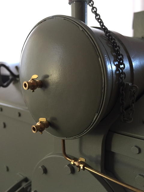

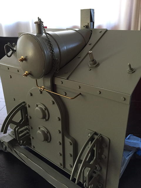

The cab interior is fully assembled and painted in the light gray/green color I selected for the interior. Some new details are visible including the drain cocks and gas cap with keeper-chain on the gas tank and the bearing caps on the transmission, I made a wood stand for this assembly so I could work on the wiring and do all the paint work with relative ease.
Here is the gas cap...
...and the drain cocks. The handles on the drain cocks move.
I also added this instrument panel for the provision of a couple gauges, most likely an oil pressure gauge an an ammeter. Stay tuned for those. The sander pull-lever is also shown.

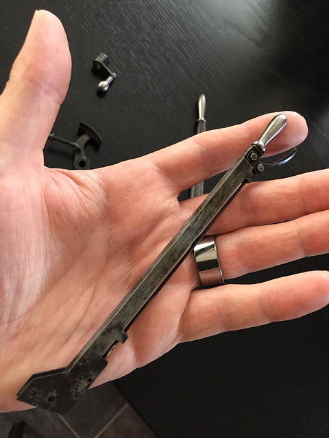

The steel levers were weathered by dipping them in a chemical blackener. I then gave them a light sand with some 400 grit to bring out some highlights. They were then oiled to prevent any additional corrosion caused by the blackening solution.

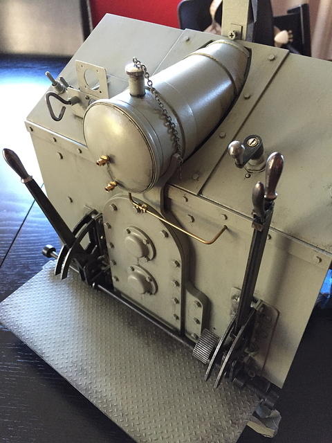

The rest of the levers. Also notice that I added a linkage to the clutch pedal. You can press down on the clutch and it will spring back.
Here is the weathered cab interior ready for installation. The grimy effect was done by brushing dilute black acrylic paint into all the crevices. Excess paint was removed while wet by wiping with a paper towel. When the paint dries you can also remove it with a Mr. Clean "Magic Eraser" This allows me to dial in the grime to exactly the level I want. I then went back with some silver paint and drybrushed a few highlights on areas that may have wear like the clutch pedal and various corners and edges. When I am satisfied with the weathering I then seal everything with a matte clear coat. This step had not yet been done when the photo was taken.
Here is another shot of the completed cab interior. The scale treadplate is made of aluminum. I bought it on Evil Bay. They sell it for scale radio controlled trucks.

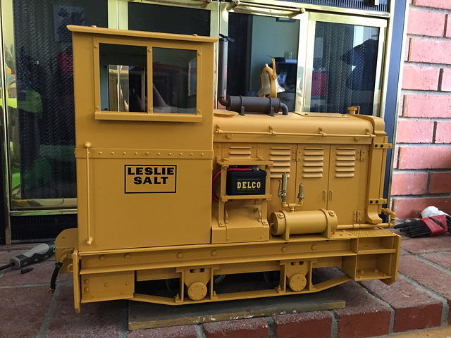

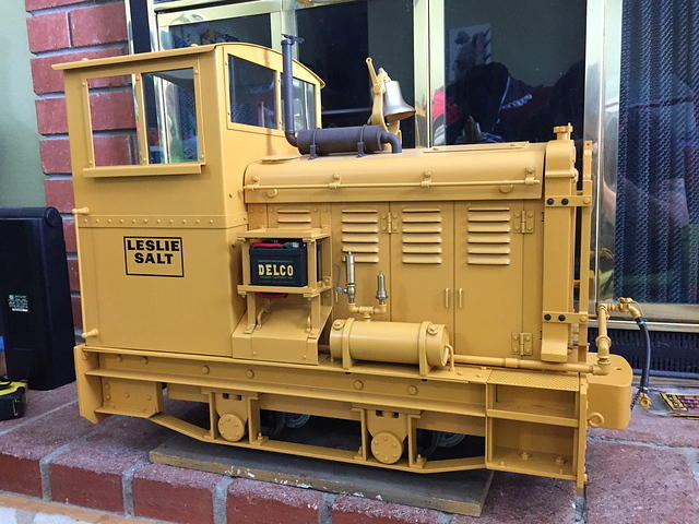

Astute viewers may have noticed above that the locomotive is now lettered. This logo was taken from an actual Leslie Salt locomotive. It was drawn up in illustrator and then vinyl decals were made by G Scale Graphics.
And a couple more shots showing the installed decals:
