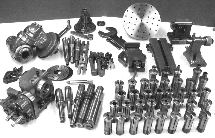

On the Pratt & Whitney 3C, the end mills are held in collets, as there were no end mill holders available from the manufacturer (based on the user manual and sales catalog for the machine).
The collets, however, are not tightened with a handwheel, but with a wrench about 6" long on a fine thread, so you can really get some bit on the end mill. It's the wrench on the top middle in the picture.
