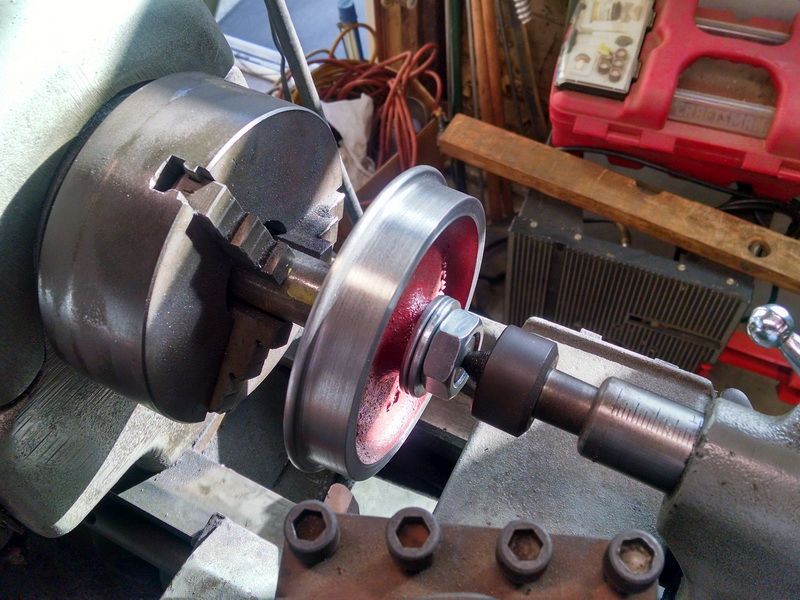

Tonight I got back to messing with the wheels. Printed out a document from the IBLS website for reference. Faced both sides, drilled/reamed center bore, made a fixture to hold it by the center bore between centers so I can work on the wheel profile. Turned the tread up to near the base of the fillet. Turned outer diameter of flange and flange width at outer edge. Started removing a little more material at the fillet, but need to make a tool to cut the radius of the fillet as well as the outside radius of the flange itself, and cut the necessary tapers on either side of the flange.

I went back to the basement to work on that wheel some more. I tried to use a radius HSS bit for the tread to flange fillet but it didn't work well, I guess a griz 10" lathe is far too light to use that. I think a shallow (but tall) radius turning attachment would work better, smaller cut per rev... may have to build something suitable.

The setup you're using is an open invitation to trouble. You'd be far better served if you could grip the wheel (assuming you can use soft jaws) than to run between centers. Also, if you must run that way, you'd be best served if you could keep the diameters as large as you can, for the sake of rigidity. The slender end you have now will encourage chatter. Keep the mandrel as short as you can, too. Anything to increase rigidity.
I am NOT a fan of turning between centers unless you can use a live center in the tailstock. Even then, I avoid center work, the exception in this case being unless the item is ground. Center pressure, for grinding, is established by spring pressure, and is not a problem like it is when turning.
Turning between centers is almost always a slower process than gripping by other means. There are exceptions.
Form tools tend to be troublesome unless one has a VERY robust lathe. You most likely will experience chatter when generating the corner radius of the wheel, but by careful manipulation of a form tool, you can limit the amount of area that is in contact with the wheel, limiting, or even eliminating, chatter. Couple this concept with the one of making a far more rigid arbor and you may enjoy success, even with a light duty machine. Increase feed rate and reduce spindle speed when chatter is an issue.

This is how I turn wheels on my 12 inch Craftsman Commercial lathe. These wheels are 4.125 inch diameter at the tread and the material is cast iron. The mandrel was made from 1 inch diameter tool steel and has an axle diameter of .625 and threaded with 5/8-16 and a nut & washers. Tight against a shoulder. I can place the mandrel anywhere into the 3-jaw to get as much "rigidity" as possible. I always put the mandrel into the 3-jaw with the same area of the mandrel at the #1 jaw........the same set-up as I used to turn the mandrel. Note the lack of chatter and note the simple radius tool to cut the flange fillet. 1/2 inch square tool with "soldered" carbide tip. Also note how close my live center is to the wheel I.m turning. Keep everything as close together as possible. The more rigid the setup, the less chance of chatter.

The mandrel shown in my previous post was a first hack at it using what I had on hand... I may try making a beefier one tonight since I will have a lot more wheels to turn. I picked up a larger nut that will allow me to keep the "stub" on that end to a larger diameter, and I have some beefier steel to try a second attempt at making it. I like the idea of turning between centers so it's easier to swap wheels when doing multiples. I could try putting the headstock end on something besides a center... just slower to swap, and I assume less precise?

Jawn wrote: I could try putting the headstock end on something besides a center... just slower to swap, and I assume less precise?
Not necessarily. One of the options open to you is to use tailstock pressure to drive the wheel. That requires a live center, but you can turn a spud in place, on which the wheels simply slide on. A pressure plate is then used between the wheel and live center, which drives the part. The spud would require a shoulder on the side that is gripped in the chuck, so cutting or tailstock pressure wouldn't cause movement of the spud in the chuck. Once machined, you can remove and/or replace a wheel by simply backing off the tailstock. The one negative aspect of this type of setup is that you may have trouble with slipping, depending on the depth of cut and amount of material to be removed. It's great for finish cuts, not so good for roughing, and works best on robust lathes.
