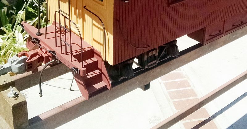

Post by Gary Armitstead »
RN,
Thanks for the tip on using Steve's new journals with the bearings. My 36 year old caboose (recently restored by to its "glory days") still has the half-bearing brass in the trucks. I have been wanting to change-over to ball-bearings and now you have shown the way. I have a new print from Steve showing the new drilled holes in the bars is now 1.188. I don't have my old prints anymore from the build of my ten-wheeler to check the old dimension. I really don't want to change the bars if I can get away with it. Are the bars on your trucks made to the old prints that Gene had?
Gary Armitstead

Gary Armitstead wrote:Image
RN,
Gary:
Nice caboose! It has survived the years in good shape.
I used the original frame bars and simply made one new mount hole - as described - for the inner bolt on each box. I did not even weld in the old hole, because the new axle box design has a "captured" bolt through upper and lower ears. In fact, I never even unbolted the bar frames from the center casting! I milled the new holes with all assembled.
I did mill shallow grooves in each new box (< 1/16" deep top and bottom) for the bar frames. This made assembly and alignment much easier.
My goal was to make the conversion replacing as few parts as possible. I could have used the original wheels with new axles, but I like the new spiral-backed wheels now offered by Allen of Nevada, so made those too.
And now I have wheel and axle box sets for another pair of trucks, if desired.
Anyone want the old parts? Let's make a deal...
~RN
