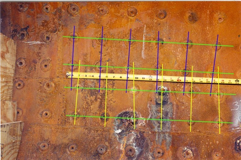

844 was one of the seven 800 class that did not receive a whole new firebox in its service life. The combustion chamber from 5 o'clock to 9 o'clock was from the factory as was the bottom of the combustion chamber throat sheet. All the other sheets had been replaced piecemeal. UP was getting 350,000 miles out of a set of side sheets in the late 1940s. The crown sheet was installed in its later life but was located 3/4" down and 1" forward from where it should have been.SP&S700 wrote:As to the 844 firebox she has had extensive Firebox repair/replacement just in the last 17 years. If you look at the before pics it is from poor water treatment. I kind of think they may have used Mig, but maybe not I have no knowledge and have not seen up close pics to tell.
This resulted in pandemic staybolt breakage.
The new firebox was installed with Tig roots and 7018 fill passes on all the seams and and flexible staybolts. Rigid bolts were threaded on both ends.

Wow! That's quite a miss-alignment between the old and new sheets. (I am assuming the stay bolts should have been uniformly positioned on the sheets.)
With that asymmetrical stay bolt pattern it's no wonder there were failures.
