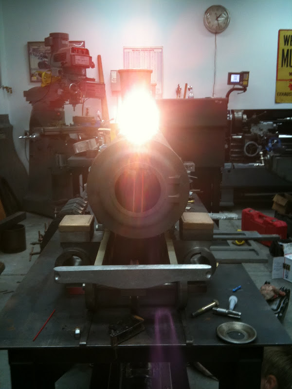

3 things,
I like your shop!
Why do the frames get ground down to true size?
Whats the steamer behind your project there on the bench?
Kevo
Oh and your project looks real good too!

Hey Kevo,
Thanks! It's a great shop and I have been much more productive since Dad and I built it.... You can really crank out some work in there! I do apologize for the general dirtiness as I haven't done a BIG cleaning since finishing the truck this last month... I just had to start machining parts!
The frames are slightly warped at this point and a little love with a hammer or a press and then a trip along the Grinder will make them nice a perfect. You could go without but it's nice to have certain things be right on the number.
Harlock covered the Chloe, but there are a few more loco's in the pic. The little Black one directly behind this engine is a Ultra Neat 3.5" gauge 2-8-0 built by Jim Vail. Jim is the fella that continues to provide outstanding modeling tips in each issue of Narrow Gauge Gazzette magazine. The engine is a exact copy of the slick little outside frame 2-8-0's that ran down in Mexico. It will be for sale here shortly......

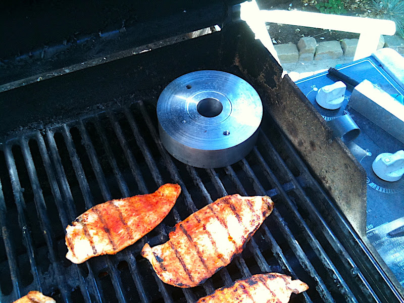

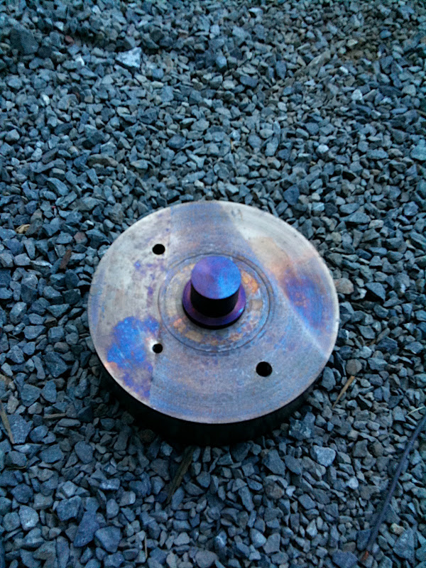

So the wheel arbor needed to be reassembled then machined to fit the bore on the wheels. To get these parts together as one I opted for the Shrink method.... My favorite....
Erin is not much of a fan when it comes to using the Household Oven so I'm stuck with using the BBQ.... Here we are right alongside the Chicken for the evening. :)
Here is the end result:
This thing was hotter that hades all the way into the evening... Yikes!! I went out at 10:00PM to take it inside the shop and it was still simmering quite nice.

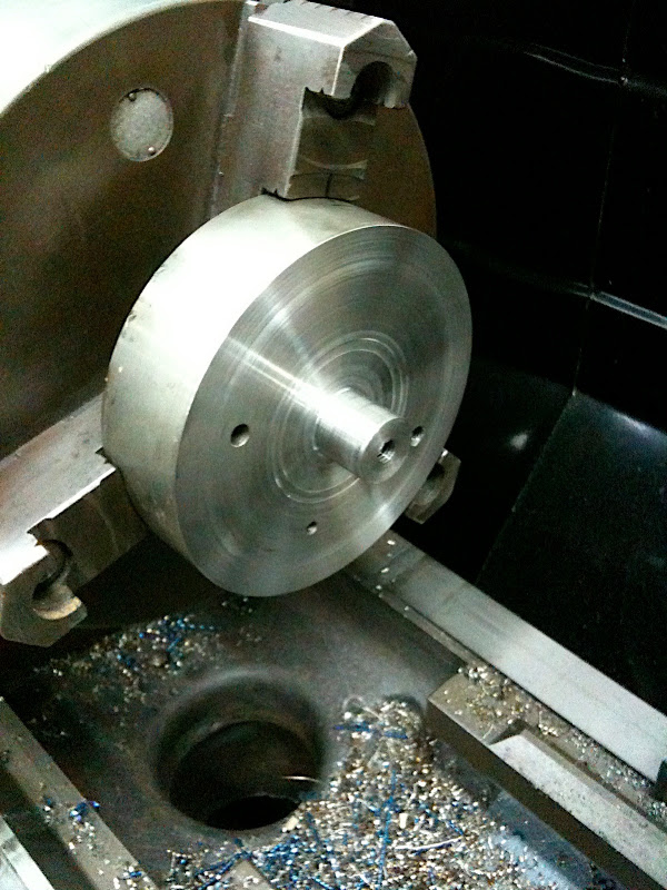

After it came back to earth I chucked it back up and put some love on it... The center pin is a nice ring fit into the axle hole. I drilled and tapped the end for a big 3/8" bolt as a retainer and we were off to the races!

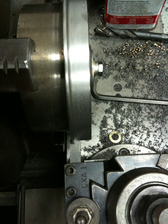

1. Tread/Flange OD's were done along with getting the flange to the correct thickness.
2. Tread taper was put on next.
3. Finally here we are putting the tapers on the flange and cleaning up the radius' around the top.
