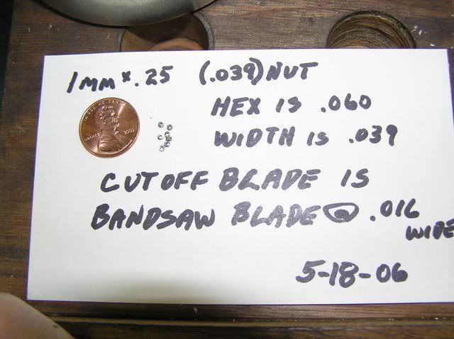

Post by Rich_Carlstedt » Sun Nov 15, 2009 11:47 pm
I use hacksaw blades for cutoffs all the time.
You just grind them, do not try to heat treat.
here are two pics showing the nuts I make for a .039 thread (1mm-.25)
the second photo shows the hex stock being parted off..
It also is showing a blade ground down to .016 and it fits neatly in an Aloris AXA cutoff tool holder
Rich
I also used the blade to cut a .171/.140 square thread with .016 forms
That picture is to follow
