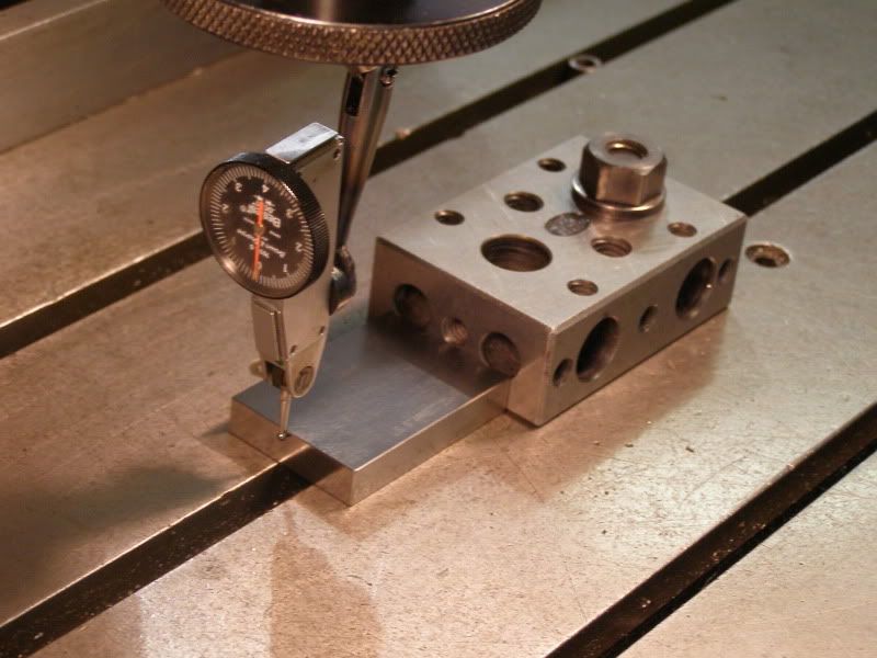

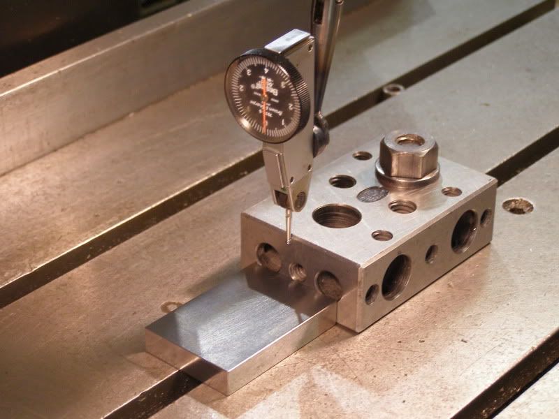

Post by GlennW » Sun Dec 20, 2009 7:50 pm
I check this way, which is similar to Dave's method, but with a little less room for error 'cause I'm anal.
Clamp a 123 block to the table and square it up to the axis of travel. Then place or wring a gage Block (or stack of) against it.
Move up to the Gage Block from about an inch away and touch it to zero the DTI. Zero the handwheel dial or DRO. Now raise the quill to clear it and then move to the 123 block and touch it until the needle zero's. Your DRO should match the Gage Block length.
This way nothing moves or backs up, and the leadscrew is always pre-loaded in the proper direction. If the spindle is square to the table the slight Z movement is irrelevant.
