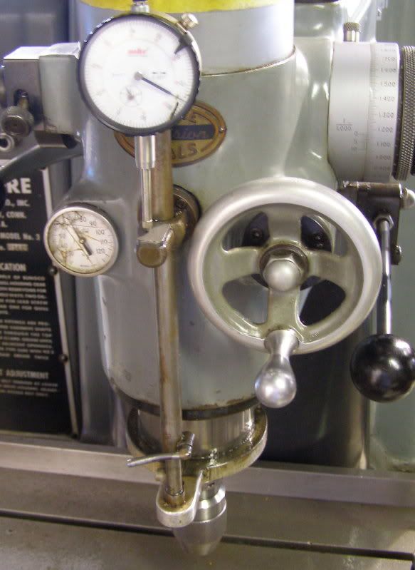

Something for the milling in tenths on knee mill guys to consider.....
The perpendicularity (tram) of the spindle to the table can change when the knee is locked or unlocked or moved up and down.
It will most likely happen to a lesser degree, if at all, when moving just the quill.
Not to say it's a bad idea to have one on the knee, Just that
there is a good reason for more accurate machines to have quills or a vertical column on which the head travels, but not movable knees.
Having a secondary form of position indication other than the dials on both would be useful for better accuracy. Possibly just an adjustable slide with a 2" travel dial indicator on the knee such as some use on the lathe carriage would be inexpensive and useful when needed.
I have a machine that someone had installed a simple telescopic rod with a quill clamp, indicator, and a stop. It's quickly adjustable, accomodates the full quill travel with a 1" travel indicator, and is very useful.
