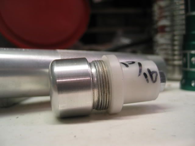

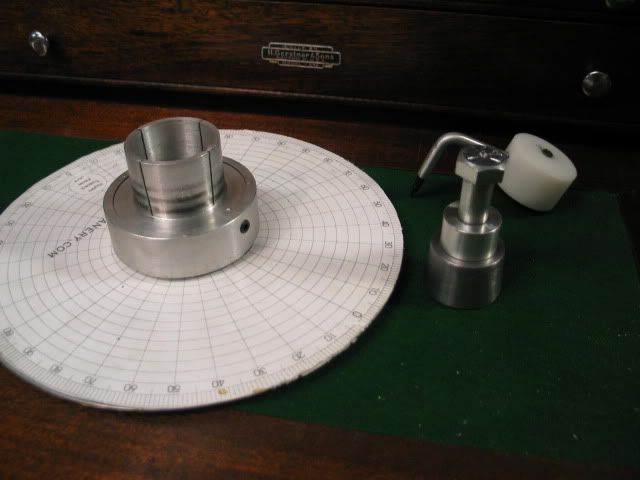

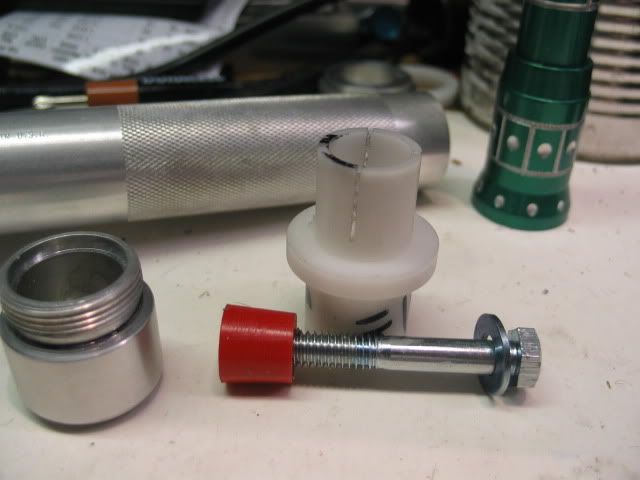

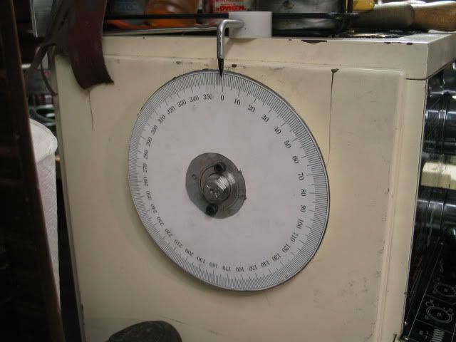

Post by coal miner » Mon Mar 22, 2010 7:35 pm
Make your own works for me also . Use a 3 or 4 degree on the mating pieces and tap the inside piece to snug up in the taper ,letting the outside expand and grip the I.D. The first one is a part that had to have some knurling removed on the O.D. Used some delrin that I had , worked good and had a 15/16" turned on the end to put in a 5C collet to spin indexer for further mods in the mill .
The other one is a degree wheel for the spindle on the lathe . Same design , won't screw up the threads .
