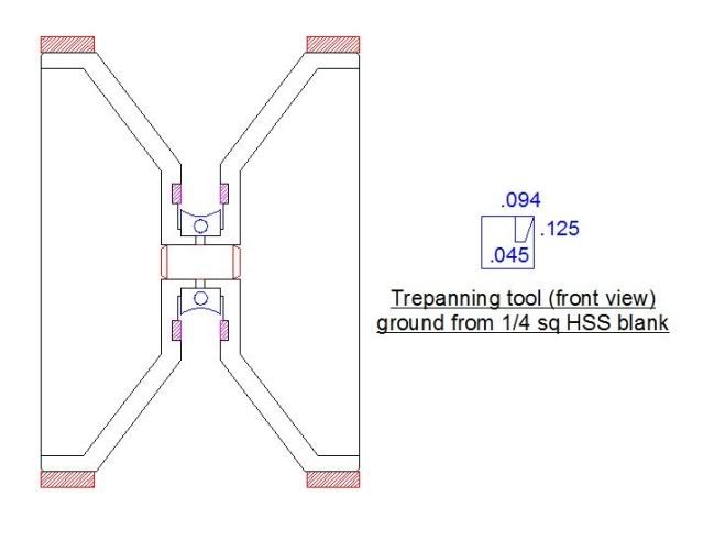

This is the design that we conceived (chamfer/radii of sharp corners not shown). To provide a scale factor, the yo-yo is about 2.300 diameter x 1.625 from rim-to-rim.
There isn't much in the design that is dimensionally critical other than the ball-bearing interface, the low-friction pad grooves and the fit between the hubs and the rims. BUT it's important that the yo-yo be well-balanced, according to my nephew. I arbitrarily decided that non-critical tolerances should be +/- .005 inches which is not normally a difficult requirement. In this case, several angular transitions exist so it's important to account for backlash in the cross-slide and compound-slide. (Determined by measuring the lash in the cross and compound slides with a travel indicator, noting the dial reading error.)

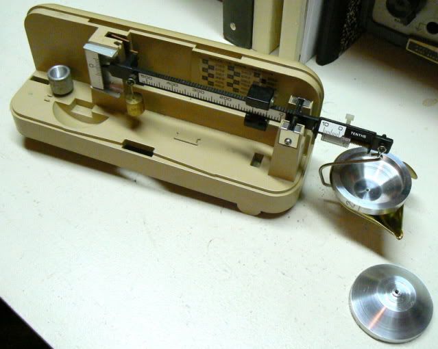

FWIW, the lab balance, like the one in the photo, is used by those who load their own ammunition. The scale has the capability of resolving tenths of a "grain", up to 1000 grains. The scale is capable of differentiating weights down to .0000143 pounds or .00023 ounces, at least in theory, up to a maximum of around 2 ounces.
This was an interesting exercise: comparing the calculated weight of an object with a complex shape with the actual weight.
Rather than drilling a pilot hole for the #8-32 tapped hole in the center of the yo-yo halves, the hole was bored with a 1/8 diameter end mill - for maximum concentricity with the other features. Finicky work but this is the type and scale of work for which I purchased my "Compact Eight" lathe some thirty years ago. (Most of my work - prior to retirement - involved workpieces that fit within a MUCH smaller envelope than 8 x 18 inches.)

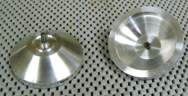

The mandrel is a 2-piece device, a removable section threaded onto a fixed stub that is secured to the spindle (held in 3-jaw chuck). The removable part can be supported by the tailstock center for rigidity. I wanted to perform final finishing operations with the yo-yo completely assembled so that all features would be concentric. The hubs were secured between mandrel parts, separated by the ball bearing and steadied by the tailstock. Making the mandrel was a routine task but a few items are worth noting. The mandrel was made from 1018 CRS, cut to length on the ubiquitous small Chinese horizontal bandsaw.

The faces of both mandrel parts are slightly undercut so that the yo-yo hubs are gripped at the perimeter of the mandrel - to minimize flexing during subsequent turning operations. One might question why this would be necessary but the several different facing operations and the many interfaces (between the hubs, the bearing race and the mandrel surfaces) suggest that a problem machining perpendicular and concentric to the spindle axis is possible. Making peripheral contact - as opposed to uncertain contact across a wide surface - is likely to produce the most satisfactory results.
And this is the completed mandrel:
The hubs were mounted in the mandrel and finish-turned to final dimension. At this point, most experienced machinists will be wondering how these very thin-wall parts, turned from solid bar, were not singing like a tuning fork and producing distinct chatter marks.

After weighing the halves, they were reinstalled on the mandrel. The final lathe operation of the yo-yo was completed by facing the rims flush to the hubs and turning the rim OD to finish dimension. Removing the halves from the mandrel and re-weighing, the two parts were within 5 grains of one another (0.01 ounce). The O.D. of the yo-yo was intentionally left about .125 oversize so that Kurt could test drive it before further modification. (It's always easy to remove more material and lighten the device - the converse isn't as simple, LOL.)
After trying out the yo-yo, Kurt liked the diameter of the rims but felt that removing five or ten grams would be helpful. We decided to lighten the hub because removing material from the hub wouldn't reduce the spin time since the greatest mass is in the rim. At this point, the yo-yo is very difficult to fixture since the walls are quite thin and flex easily. I made a "collet-like" split clamping device from a slice of 4 x 4, bored to fit the O.D. of the yo-yo halves and split diagonally, part-way through, in the table saw. (This could have been held in the 4-jaw on my rotary table but this was quicker than mounting the sixty-pound monster.)
Installing the halves in the split block, clamping in the mill vise and applying some side pressure with a "C" clamp held the thin parts so that 7/16 diameter holes could be plunged in the hubs. The intention was to produce eight holes in each hub but Kurt stopped me at four holes - he wanted to try the yo-yo again before plunging the remainder of the holes.
We reassembled the device and Kurt pronounced it perfect, in terms of size, balance and most especially spin time. Here's the yo-yo prior to de-burring, polishing and coating with shellac - all of which will be performed by Kurt. The teflon washers and the ball bearing have been installed and this thing will spin for a l--o--n--g time !

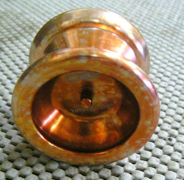

Some of those questions were posed to my nephew a few weeks ago, he didn't know of any limitations in weight, shape or size. Regarding the parabolic curve, he does have a couple of yo-yos that are radiused in cross-section, I don't know the shape, however. His expressed personal desire was 2.25 diameter x 1.625 wide and 65 grams total weight. We ended up with 80 grams and the thing just seems to spin forever !
Recall that my participation was limited, I suggested the composite structure with heavy rims, made the inertial calculations and served as Kurt's "hands". The shape that we produced (a very odd 37.4 degrees off vertical) was one that he selected based on a commercial product that he felt had good performance. (He has a LOT of these things and they aren't cheap - around $100 each, I think.) The string is attached with a simple slip-knot to the bearing as I recall although I wasn't paying much attention when he attached it.
I have a tracer attachment for my lathe and I have used plywood patterns (with taped edge) on it to copy - exactly as you described using an indicator (moving s-l-o-w-l-y). There is another neat trick for facing arcs that I learned from a NASA publication a long time ago. I've been thinking about posting it here for a while and probably will when there is more free time. (It's a great way to produce both concave and convex shapes - amateur telescope makers might be interested.)
I hope that Kurt will bring the finished yo-yo over sometime soon so that I can photograph it in polished and finished configuration.

happy boy + toy:
