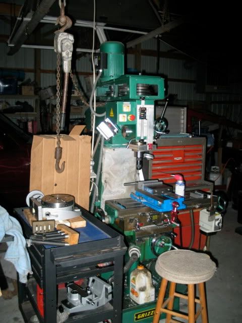

I whipped up something to lift the rotary table using the cherry picker. I needed to get it off of the workbench. This will work for now. Once I have the mill in its final resting spot then I'll make a wall mounted swinging crane arm.
Ed
Ignore the dangling eye bolt. That was an "Oops!" when I found out the hook would not go around the 3/4" rod.

Ed , like your lifting apparatus . Looks like the RT hangs even . I will have to copy it , maybe make the cross bar from Al to keep from bunging up the inside , just like your hangers. The engine hoists are handy for so many things , especially after putting an air/hyd cylinder on it . No more pumping .
I think my set up will work out OK . Had the tool cart not being used other than to collect stuff . Why is it when a flat surface becomes available it immediately disappears under stuff you never knew you had ? The old come along , hung from apiece of 4" channel across the rafters , is a 1000# cap ,so it is small and handy . Will have to run the table back and forth , so I should be able to take the Kurt off and put the RT on and save my spine .
Notice the high tech chip shield .

The 5/8" bolt that goes through the center of the rotary table has a piece of 3/4" aluminum tubing over it so it doesn't bung up the Morse taper in the rotary table.
