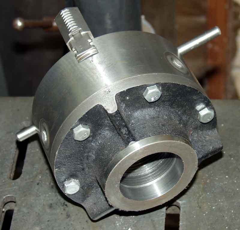

My lathe has a threaded spindle, of an odd size, and I want to make a backing plate for a 12 inch chuck, I want to fabricate one from a piece of shaft and a peice of plate, I would probably use 1" plate for the backing plate, and a scrap of something close to 4 inch shaft for the threaded hub. The spindle is 63mm x 6 tpi.. I could taper thread the plate onto the hub, or weld it on. Yes I am doing this because I am cheap. I would also rather make one than buy one. I would like to see a discussion on this.

You should make a copy of your threaded spindle, including the distance to the shoulder, for a test plug. Once you have that, as you make the backing plate, you can use the plug to test the fit. That way you don't have to remove the backing plate from the lathe until it is done.

Yep what Patio says. I'd even go one farther and recommend making the female part as a spindle protector. You'll likely need it later and it's good practice.
I'm not sure I'd want a steel back plate especially a 2 piece. I've seen people make them from cast iron barbell weights.

I use to have a Jet lathe with a 60mm x 8 thread on the spindle. I made a backing plate from a barbell weight. It worked great. I made a welded backing plate for a Sheldon I use to have and it had issues with chatter. It seemed to me to be more springy and less ridgid than the cast iron plate.
The plate was not quite thick enough at the hub to fully cover the spindle sp I cut a counterbore in the weight and pressed an extension into it to make up for the short comming.
I bought this collet chuck which had a 2-1/4 x 8tpi in it. I bored it out to the 60mm x 8 size I needed.
Having made backing plates these two ways, I recomend 1: finding a plate with a slightly undersize thread and boring it out to your size or 2: just buying a backing plate blank to start with. The weight worked great but finding one the correct size is not that simple.

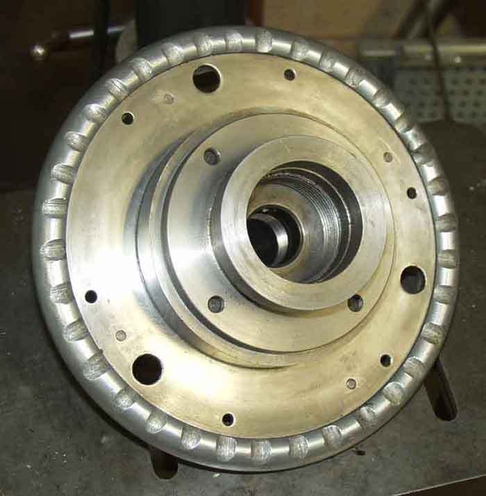

I have a Hi Tech SG 2 Lathe, from chaitanya machine works in Rajkot India. I imported it myself in about 2000, it cost $2900 fob Mumbai, with a cooling system, a taper attachment, a 8" 4 jaw and a 6" 3 jaw. I still use the live center it came with. It takes a #5 MT in the headstock and a #3 in the tail stock. It will cut all the metric and standard threads. It will swing 16"x48" over the bed between centers, and 10" diameter over the cross slide, and 23" diameter in the gap. They reccomended bigger chucks, but I could not imagine why I would want them, and true enough, I could get by just fine without them for the work I will do. I would like a bigger 4 jaw as it has a bigger hole through it, but that is all, I do not expect to be swinging anything bigger than 8" diameter. I bought this to learn to machine on, and I am quite happy with it ten years later. It has an adjustable tailstock, and I always have to shift it if I want to do very accurate work. I bought a lathe this big as I thought that some day I might want to drill rifle barrels, but I am not there yet, and am fairly sure this is not the machine for it if I wanted to. It does have the odd size spindle, but I did not know enough at the time I bought it to look for one with a lock on chuck system. this is a link for a newer model, with a shorter bed. http://www.hitechlathe.com/Trainer_100.html
(they did not sell them as trainers when I bought mine. )
While this is not a production model by any stretch of the imagination, it will do almost what ever you want a lathe to do if you take a little time. It will take a 3/4" tool in the tool post it came with, and I bought a QCTP for it.
There are many more distributors of lower priced lathes now than there were then, but have a look at their website, they build some interesting machinery.
My lathe in my messy shop. that tool box holder I built on top has a large edge to keep anything from rolling into the work.
