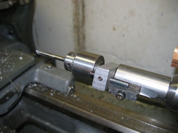

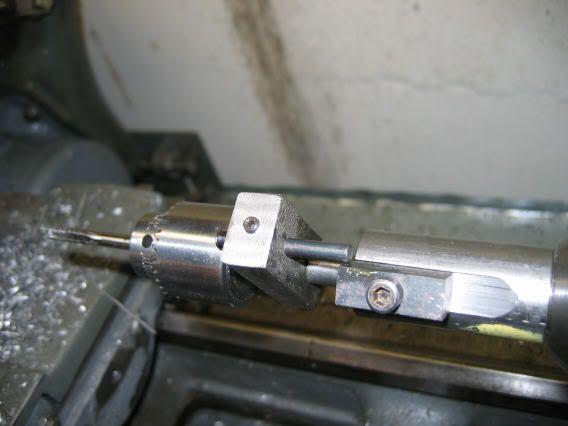

For the long thread, the die won't hold a good pitch.... if you can single-point the thread with the lathe, it will be more accurate. if no concern for exactness, you can do the thread without using the lathe at all, just the die in a hand diestock and work in a vise.
if the concern is the lathe speed, which I agree is an issue with most asian machines, there are solutions.
1) modifications..... There are a number of modifications for the smaller machines to get low and controllable speeds. Since you ahve 160 rpm, probably you have one of the "230 x 500mm" size machines, since larger ones are doen to 100 rpm. Look around on teh web for your machine.
2) releasing die holders..... you can thread at virtually any speed with these, and you can make them yourself.
here is a releasing tap holder, but a die holder would be about the same.... Advance the T/S until the tap "starts", then stop advancing... the pin drives the tap until it slips off the block and spins free.... then you reverse the machine, and advance just a bit more to engage the pin again. it backs out as you reverse the tailstock to a disengaged position.
Depending on the depth you want, you change your advance distance. Idea is out of "Toolmaking 1935", a Lindsay reprint book, unfortunately not available overseas, most likely.
original type has a setup such that it engages on pull back, avoiding the need to advance and then retract to back out the tap (or die)
Starting position
Positioned about to "release"
Edited because one sentence didn't make sense
Starting position
