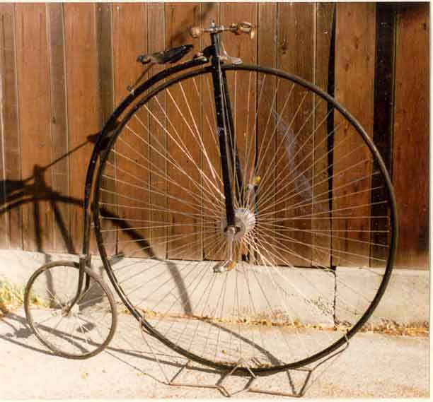

Your question is a little like when someone ask " how big is big enough"? It is difficult to answer without a lot more information. Bending can be accomplished many different ways and the answer is dependent on many factors.
About 40 years ago I built several, old fashion, High-Wheel bikes. I had to bend the rims and frame.
I made a 3 wheeled roller to do the bending. I was 18 years old and only had a 10" Logan lathe and Delta drill press back then. It was made from junk I had laying around so it is not an optimal design but it worked fairly well. It had one adjustable roller. The stock was sent through the rollers and one roller was adjusted a little tighter and another pass made. It took about 5 passes to get the rim formed into a circle. Don't forget that the stock needs to be a little longer on each end because when the stock comes off of the roller it leaves a straight section at each end of the piece. Even though you might be able to have 3 fixed rollers, It is easier to bend the stock using multiple passes since there is spring-back in the stock and it is difficult to predict the curve you will get. My roller had an adjustable center roller but I have also seen one of the end rollers adjustable. The end rollers were comvex and the center roller was concave to fit the rim shape.
Charlie W.

Charlie, How did you decide on the distance between your two fixed roll dies? How did you decided on the diameter of those same dies? Your work is extremely nice and I would have never guessed the builder to be only 18. WOW.

STRR wrote: Charlie, How did you decide on the distance between your two fixed roll dies? How did you decided on the diameter of those same dies? Your work is extremely nice and I would have never guessed the builder to be only 18. WOW.
I didn't take a very technical approach to building the bender. I found 2 scrap plates and just placed the three rollers where they seemed to fit well and looked about right. The rollers were turned from some square stock I found somewhere. I made 7 large rims and 7 small rims with it. It was pretty crude but did the job.
STRR wrote: Charlie's bender is "upside down" from most pyramid roll benders. It really doesn't matter since the orientation does not affect the bending process. I have seen several pyramid roll benders with adjustable bottom roll dies. I am assuming the different settings would be for different materials, different profiles, or more likely different radii bends. Making multiple passes is definitely the best way to get the most accurate radius. I'm just trying to find some way to compute the best dimensions for my needs rather than by trial and error.
Thank You All Again,
Terry
I am not sure what you mean by upside down. The roller can be mounted in any position you want. I bent the 1st frame with a carriage wheel steel-tire bender. The other frames I made were done with something sort of like a conduit bender. I mounted the bender to a fixed object, place an extension pipe over the frame tube and bent it a bit and worked my way down the frame. I made a wood pattern/gage to check the shape. It was a a trial and error process.
Since it was a bike rim, I drilled all the holes for the spokes before bending it. If I had been more experienced at the time I would have added about 4 exter inches on each end where it was straight so I could cut that section off. Instead it was made to length. I pushed down on the rim to form an oval and welded the two ends together. After grinding the welds, I opened up the bender, placed the welded rim in it and bolted it back together. Then it was a simple matter to crank the rim through and it shaped the 2 straight sections to for a nice round rim.
By the way, I use to ride it. This was taken a few years after I made it. My 2 sons were over a couple weeks ago and rode it. The first time it had been out in several years.

You can say "crude" all you want. Your finished product is spectacular. I am a bicycle fan, more or less, and that high wheel could have come straight out the the 1890's.
