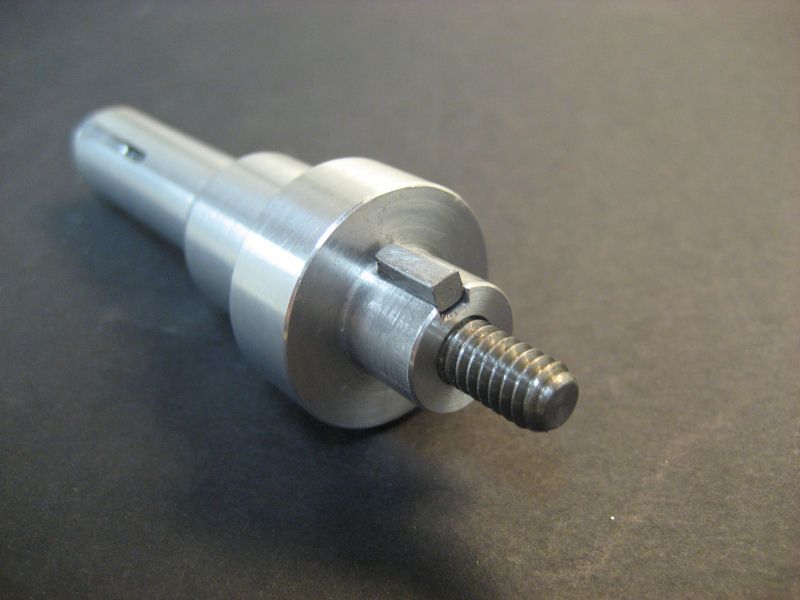

Just made this the other night for my Logan. Got tired of always having to reach for a wrench to move the tool post. Plus, one less piece of clutter. I got an old drill press handle with some tools I purchased. Just happened to match the style of the post. I just cut it down and threaded it and then made the nut. Now I can just move the handle instead of using a wrench.

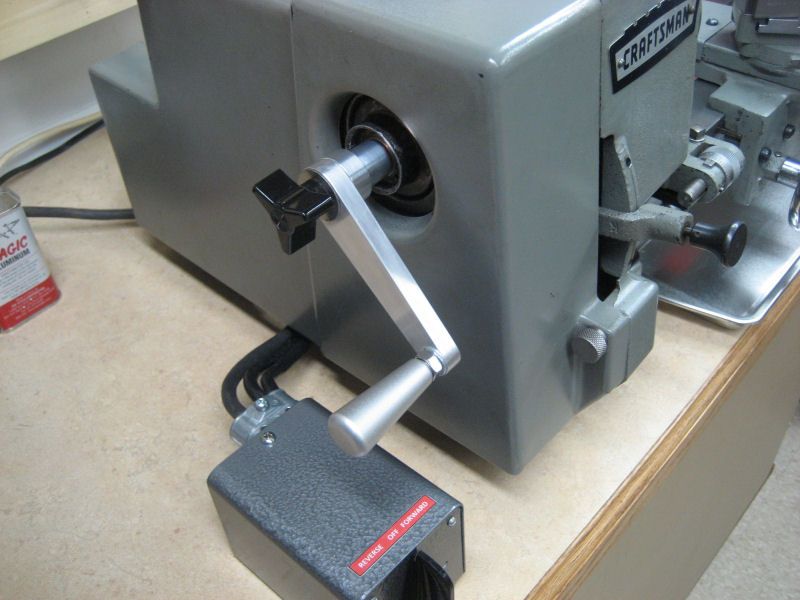

I made a handle for the spindle on my Craftsman 101.21200 lathe that can also be used for indexing using the lathes change gears.
