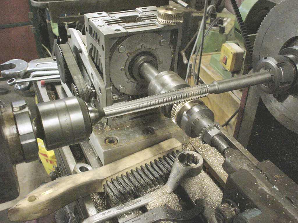

I'm in the "if it is supposed to be 40°, make it 40°" camp. I imagine a Poly-V belt would "work" on a grooveless pulley but that doesn't make it right. Look at the picture of making the pulley It has grooves, it is not grooveless. In any case many poly vee's run on grooveless pu...

Harold, I only posted this quick dodge for the people who want to actually make something. I know it's not correct in theory and won't pass any QC test but I didn't realise this board was for pro machinists working for Boeing ? Silly me for reading Home Machinists and QC in the same sentence. In def...

11 TPI thread chaser plunge fed into blank. http://www.stevenson-engineers.co.uk/files/poly%20vee%20tool.jpg Instant poly vee pulley, the purists will say that the profile isn't correct but I have these running on machines 8 hours per day, 4 1/2 days per week at 9,000 rpm with no problems. John S.
