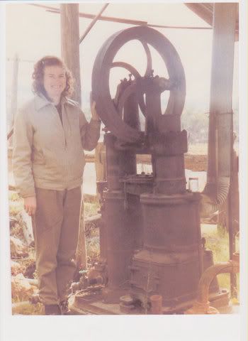

A photo from over 20years ago of a Stirling cycle hot air pumping engine that I'd returned to working order some years before the photo was taken.
Bore was about 7 inches and the stroke at least twice as long, as I remember.

Interesting!
Do you have knowledge of how it was used?

Harold,
I found an old post of mine on another forum and it sort of answers your question;
Stirling engines are great but they are very heavy and bulky for the amount of power that they produce.
I restored a pumping engine at Karingal Village (Bathurst NSW) in the first half of the 1970s.
This probably dated from the 1890s and was over 5 feet high and drove a reciprocating water pump of about 1.5" bore.
We fired it on Box or Stringy Bark [two very hot Australian hardwoods] usually and it required almost no maintenance apart from a squirt around with the oil can before starting.
It did the job for which it was designed but we only used it for demonstrations so it didn't do any serious work.
We knew an old chap who had worked this partcular engine and another one on a local property in his youth. He told us that they were hungry for wood when they were being worked hard and that he was constantly on the move so that they didn't stop. The engines were on seperate creeks and he had to ride [on horseback] between them.
Not a situation that is likely today.
Their great beauty is that they can be started and then left, as the fire burns down they get slower and slower and then stop, cool down and that's it; then they're ready for the next light up.

. . . The engine that I restored could be stopped by the friction of a work-gloved hand on the flywheel when going at full power. Probably could have stopped it with the bare hand but I have sensitive skin :lol:

Yes, it did, and I thank you for the effort. I was mostly curious about the amount of power one might develop. The gloved hand pretty well described my hunch.
Very cool engine, but obviously not very efficient.

Harold,
You're right about these engines not being very efficient, at least in terms of size versus horsepower; but in terms of the day and age in which they were used, their low maintenance requirements and the abundance of virtually free fuel in the Australian bush then this engine was efficient as it did the job for which it was designed. The degree of skill needed by the operator was also a big factor as any of the farm/bush workers of the day would have been able to operate it.
