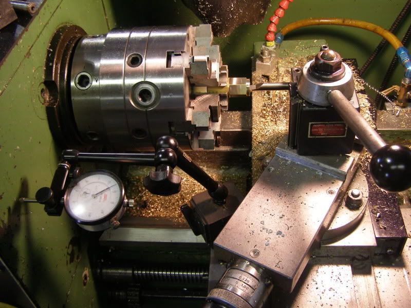

The way to make it easier to RH thread in a blind hole is to cut a thread relief at the point you want the threads to end. When using carbide inserts or solid bar threading tools, it is very important to not overrunn the previous cut threads, as it instantly breaks the tip off the tool. That awful crunch sound. A thread relief is just a groove cut as deep as the depth of the thread, and about 2 pitches wide. A precut thread relief then as a tapered portion as well, maybe a couple pitches long. If your cutting a 5/8" thread normal thread lenght would be 1.5 x diameter, so 15/16 deep.
So you have cut your thread relief, you now set your threading tool, and measure 15/16 up the lenght of the threading tool, black marker the position on the tool. Now take your first cut and listen, when the sound of the tool as it cuts, stops, release the half nuts, take the black marker out and mark a line on the ways at the end of the carriage at the headstock end. Now you will be feeding out with the compound so the mark on the cutter will move relative to the work, but the line on the ways carriage will remain the same, and you can listen as well.
Some guys forget to move the compound to the other side of the crosslide, It cutting works so much better when its advancing the cutter than retracting the cutter.

It should be noted that the relief diameter would be machined to the theoretical major diameter of the thread, not the pitch diameter. Starrett conveniently marks the double depth of threads on their fishtail gauges.
The compound should ALWAYS be set so that feed is in the same direction as carriage travel when cutting the thread. For an internal thread, RH, assuming cutting towards the headstock, the compound should be set at either 7:00 or 1:00.

michaelb wrote: It is a hit and miss situation when I thread into a blind hole and have heard the distinct sound of "CRUNCH" one too many times, relief was just not wide enough and did not have the room to make it wide enough.
Set up a dial indicator as well as the Sharpie marks on the tool shank or bed way when internal threading to a shoulder. Set the indicator so that you have only one revolution of the dial to your stopping point. Tat way you won't loose count of revolutions and you will have plenty of time to get the half nuts disengaged prior to hitting the shoulder. Keep in mind that as you advance the compound, providing that it is set to about 29 degrees, the toool will advance toward the shoulder, so take that into account when setting up. I'll bet you will find that you can stop within a few thousandths of your zero mark on every pass if you are paying attention.
